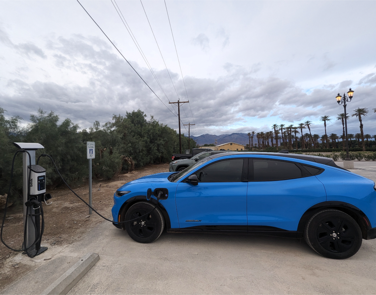

We did Death Valley a few years ago just fine in our 312 mile Mustang Mach-E from northern AZ through Las Vegas. Las Vegas was the last DCFC we were able to use. We had a 140 mile one-way drive from LV to DV. This was during the wet season when the Badwater Basin had a lake. It was busy. But most of the EV drivers were cooperative and helpful to each other. There are more even more chargers now than there were when we were. I don't think there are any DCFCs, though.
1000014186-png.14683
