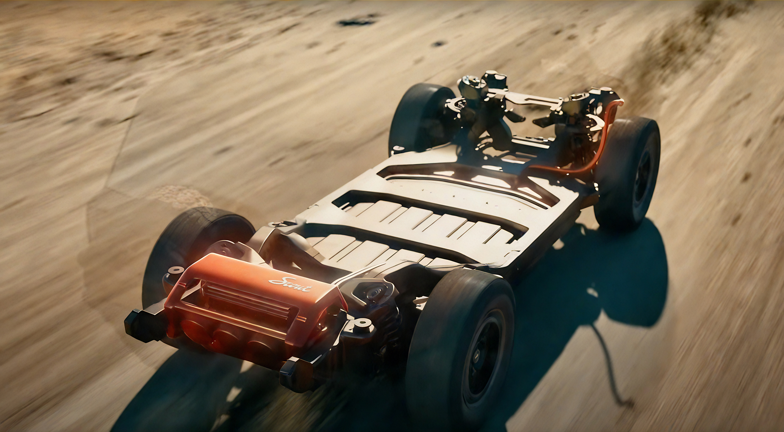

Towing with the Harvester is probably going to be mostly thermal dependent.
My speculation:
Once they set a total GVWR & GCWR with the BEV, they'll trade battery mass for fuel+engine (±) mass. Hopefully they'll place most of the fuel and engine mass forward of the rear axle so they don't lose tongue weight and thus towing capacity. It’s not at all clear to me if they’ll gain or lose mass by shrinking the battery and adding the engine and fuel. Presumably they’ll be within 100-200 pounds.
If they can manage those two things, then they'll be thermally and battery limited.
The engine will require a fair amount of extra cooling capacity, which will likely be managed by an extra heat pump powered by the high-voltage battery. That extra cooling power draw will be part of the reduction in towing capacity.
The other issue is that the Harvester will have a smaller battery. A smaller battery of the same chemistry necessarily has a lower power output maximum if battery lifetime is a consideration. The power output is dependent on the safe discharge rate, which might be—for example but not necessarily specific to the Scout battery—5C. A discharge rate of 5C means the battery can be fully discharged in 1/5 of an hour, or 12 minutes. A battery with 100 kWh capacity can thus provide up to a maximum of 100 kWh / 12 minutes = 500 kW of power, for 12 minutes. A battery with the same design and chemistry with ā€œonly" 80 kWh of capacity can (safely) provide up to a maximum of 400 kW of power for 12 minutes. There’s a whole host of other electronics that need to support the battery’s maximum power output, so don’t take these numbers for any kind of estimate of what the Scouts can do—they’re simply illustrative of the issue between large and small batteries. There are likely ways around this, and one of those is if the genset produces enough power to make up the gap between the smaller battery and its larger sibling.
The total power to the wheels on the Harvester will likely be lower, but the cooling requirements will likely be higher.
If they can get the mass mostly forward of the rear axle, my guess is that the thermal and power limitations mean they can hit at around 75% to maybe 85% of the BEV towing capacity. If they have to put some of the engine’s mass over or aft of the axle, then they’ll also lose towing capacity to tongue and axle weight considerations.

I'm still just amazed they'll be able to fit a whole EA888 engine back there (pretty sure it's not going to be the lower power EA211). All in that engine is just under 300lbs however as an EREV I'm sure there are a number of accessories you can remove making it a bit lighter. This matters because according to their original diagrams, the engine will be sitting behind the rear axle and I doubt there would be space to move it up any further.
I'm on my second EA888 engine and time has shown VW is not great at making water cooled systems for cars, especially water pumps, so I'm very curious how Scout will deliver a reliable system here in regards to cooling. BTW outside of cooling it's a fantastic and durable power plant.
Yeah, I’m ignoring that concept drawing in an expectation that they’ll shift that genset forward. If they don’t, then all the mass of that will contribute to tongue weight and reduce the towing capacity by ~10x the genset mass. If it’s about 300 pounds, then the maximum tow capacity will be lower by ~3,000 pounds just due to the excess weight aft of the rear axle.
