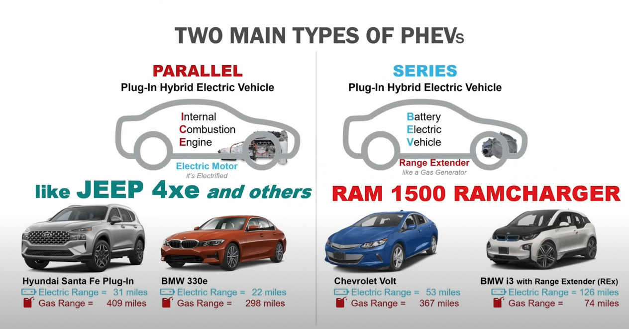

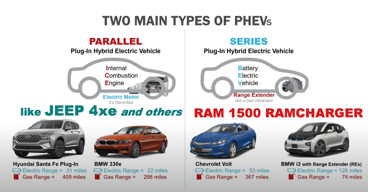

This might help...

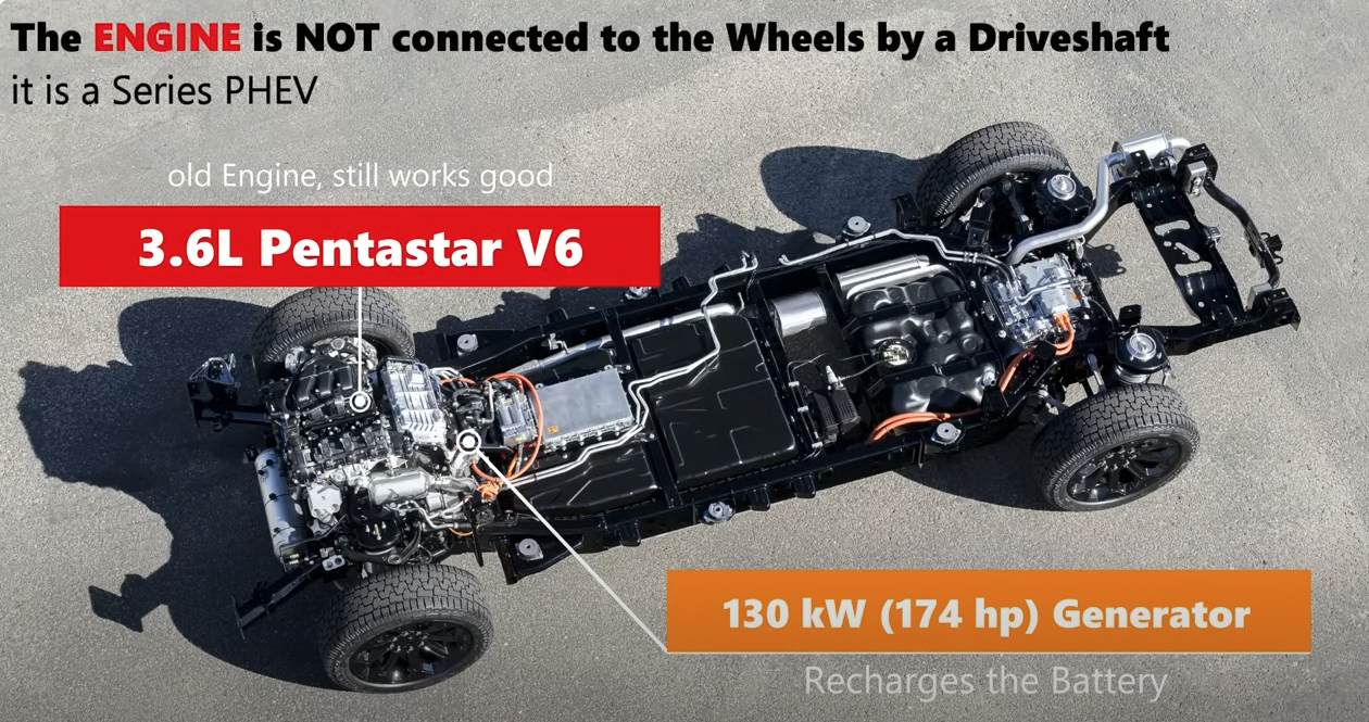

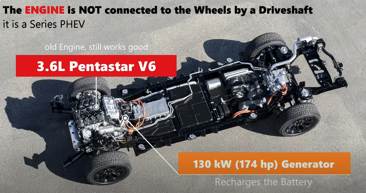

Technically, and because you do have 2 separate sub-systems being implemented in the same car, it would be considered as a PHEV "hybrid". The way the Scout Range Extender has been described is as a "SERIES" PHEV (second picture) with only electric motors turning the wheels.
The electric motors run by battery, and the battery receives its energy and electrons via direct charging AND/OR the RE gas engine:
This is what a series means in mechanical terms as it relates to a battery and the gas engine.
The gas engine is NOT connected to the drive shaft! It is used to generate electricity.
This is what the RAM set up (supposedly) will look like for its own "series" PHEV with a range extender

This might help...

Scout showed what they expect the Harvester to look like. It’s obviously not a 3.6 l V6. It’s tiny. Tucked under the floor of the rear cargo space. So the balance between battery and gas in the Scout must lean heavily toward battery. The little gas engine will significantly extend the range but I very much doubt it will maintain battery state of charge while cruising down a highway. Most of the 500 mile estimate is going to be from the battery’s initial charge.
So it must be more like the BMW i3 than the Chevy Volt. Mostly electric with, and I quote, “a little bit of gas”.

Yes, I saw what Scout showed (below) and it was definitely smaller - different design that RAM of course, but same architecture in that picture... My intention (sorry if it wasn't clearly stated) was to show the difference between HYBRID models, and that the way Scout Motors is implementing the Harvester RE is as a "series" in such a way that the Harvester powers the battery (as shown in the RAM image). The video is pretty good if you have a chance to watch it.
