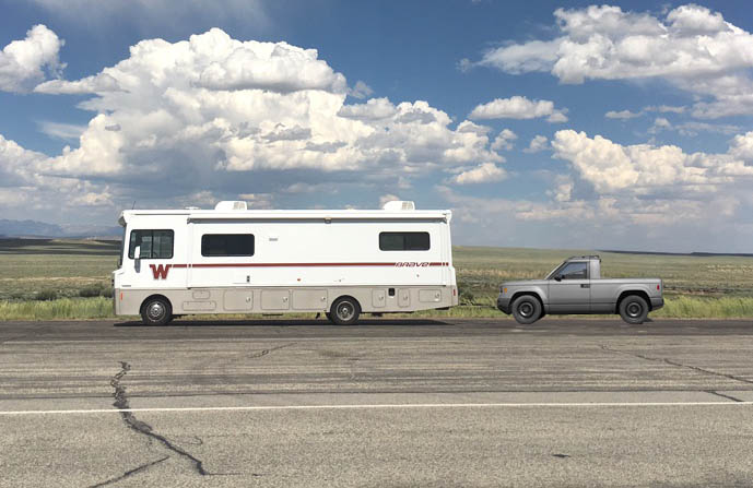

Slate truck/SUV flat tow confirmed by Slate
vmikee
Active member
It sure would be nice if Scout would confirm that flat towing will be available. I put in my $50 to get on the Slate waiting list since they have confirmed flat towing. That’s a deal breaker for me and many others…

Technically they didn’t confirm it. They are intending but as I recall-other EV manufacturers intended it initially then pulled back and said they couldn’t offer. But hey-hope it works out for you. I’d feel better seeing people flat tow a small Slate than the larger Scouts anyway. Win-win all around!
