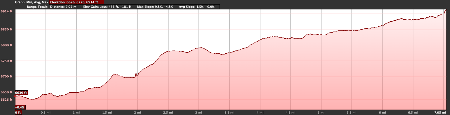

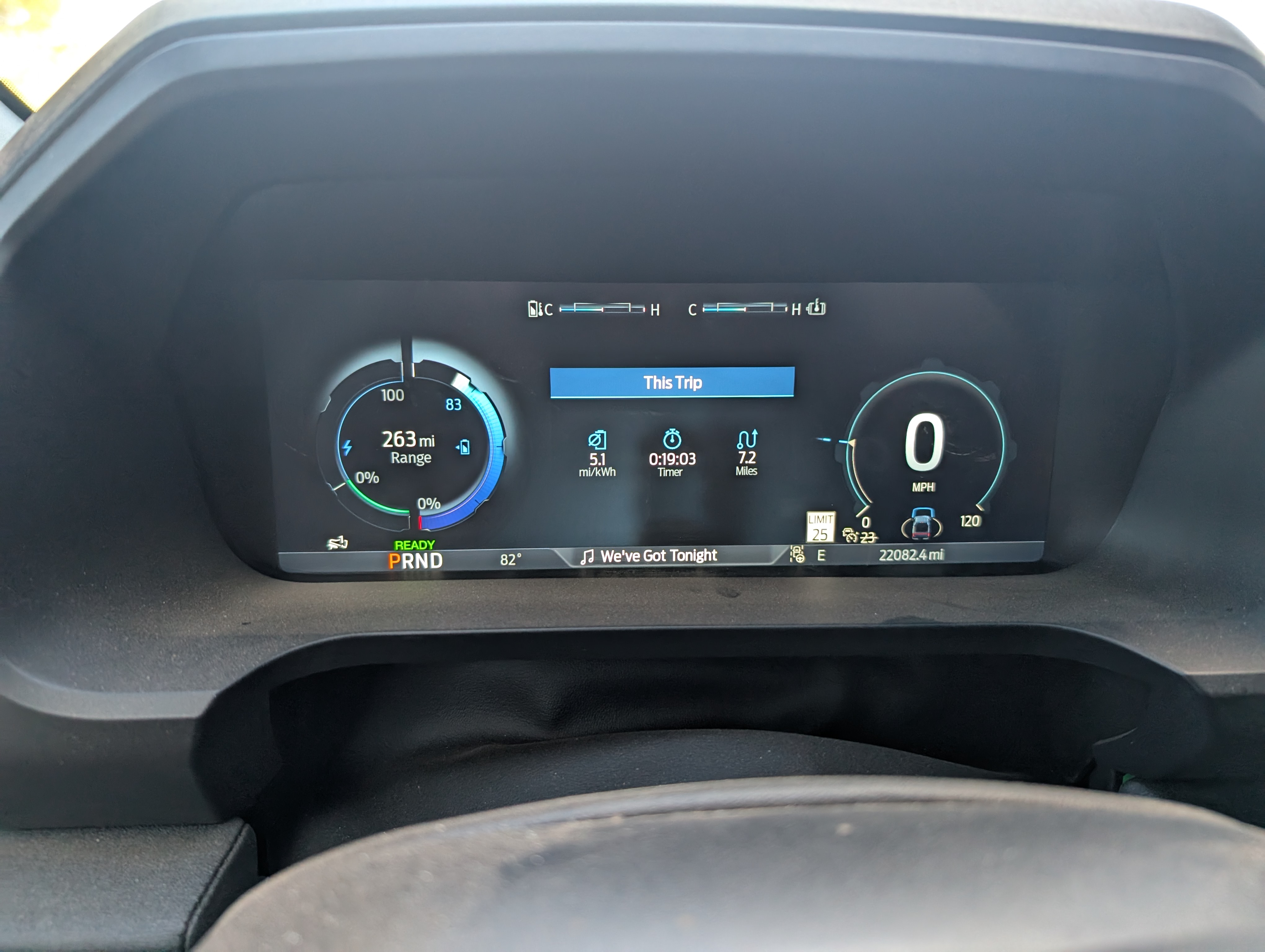

Okay, real-world driving experience just now.
I just got home from a board meeting. 7.2 miles each way. Mostly through town, with stoplights, construction, etc., but with a short stretch on Route 66 at 55 mph.
On the way there, I got about 2 miles/kWh. Average speed on the way there was 27 mph.
On the way home, I got 5.1 miles/kWh. Average speed on the way back was 23 mph.
Average efficiency was 3.55 miles/kWh.
At an average of 3.55 miles/kWh (if this was how all my trips were, which is obviously nonsense), I would get 465 miles of range.
Elevation change was 6914 feet - 6626 feet = 288 feet. Elevation profile attached.

I forgot to grab a photo of the trip meter on the way there. Here’s the one for the trip back.
