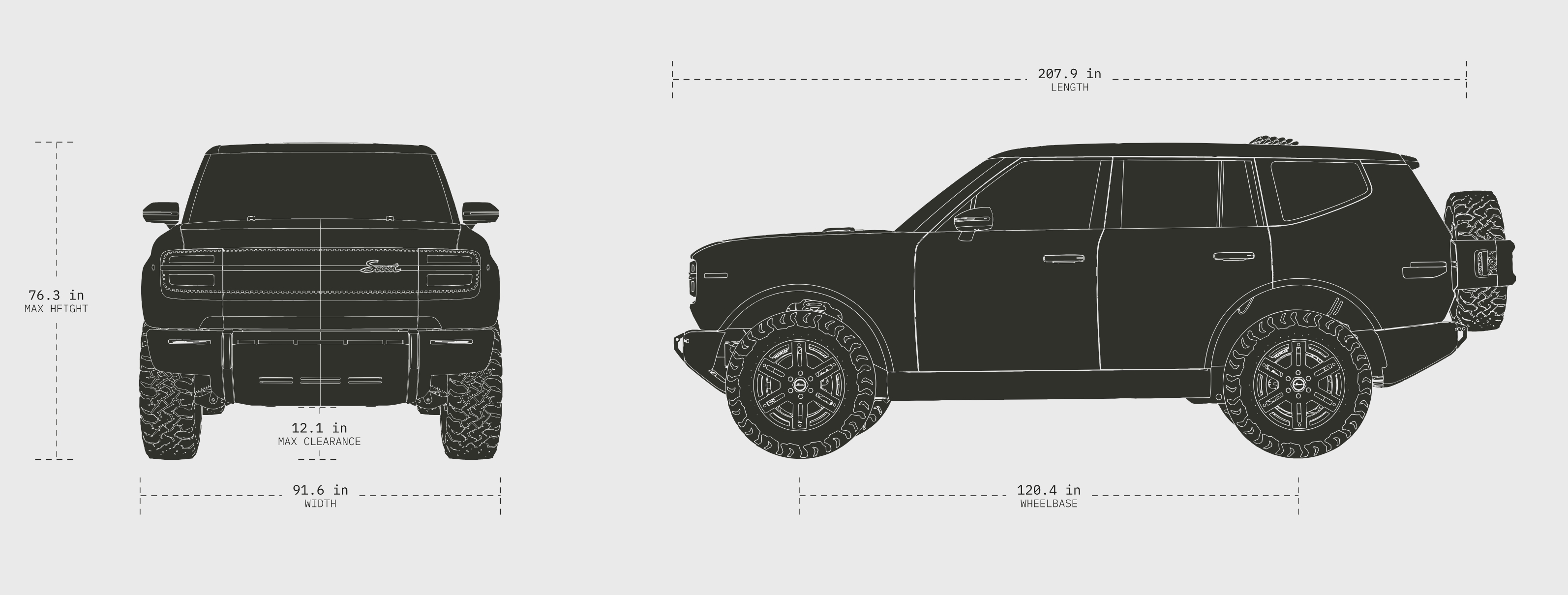

I don’t think the width value is correct.
I measured the height and width of the vehicle drawing precisely with calipers and found the width is 1.127 times the height. If the height measurement is correct at 76.3 the width is actually about 86.0 in (with mirrors because they do not project).
Hopefully, we’ll get some clarification.

It is hard to tell exactly what is being measured, though. The drawings use a perspective projection, which makes the parts that are closer to the viewer larger (wider and taller) than the parts that are further away. If they had used an orthographic projection, you would have been able to measure bits of the drawing (like tire hight) in order to double-check the sizes. The perspective projection looks a lot better, though.
Good point. Since there is some perspective the front view drawing should make the roof appear relatively low vs the width because the front of the vehicle is closer and the roof a bit further back. That means my earlier measurements and calculation of an 86.0 in width (based on the height to width ratio and assuming the height measurement is correct) was too large. I now think the width is less than 86.0.
Anything over 80.0 in must have the extra lights required on a wide vehicle and I didn’t notice these on the prototypes they showed.
I hope they will show us one in a parking space soon so we can get a good idea of the size. And at some public space so it’s a pretty representative size space
