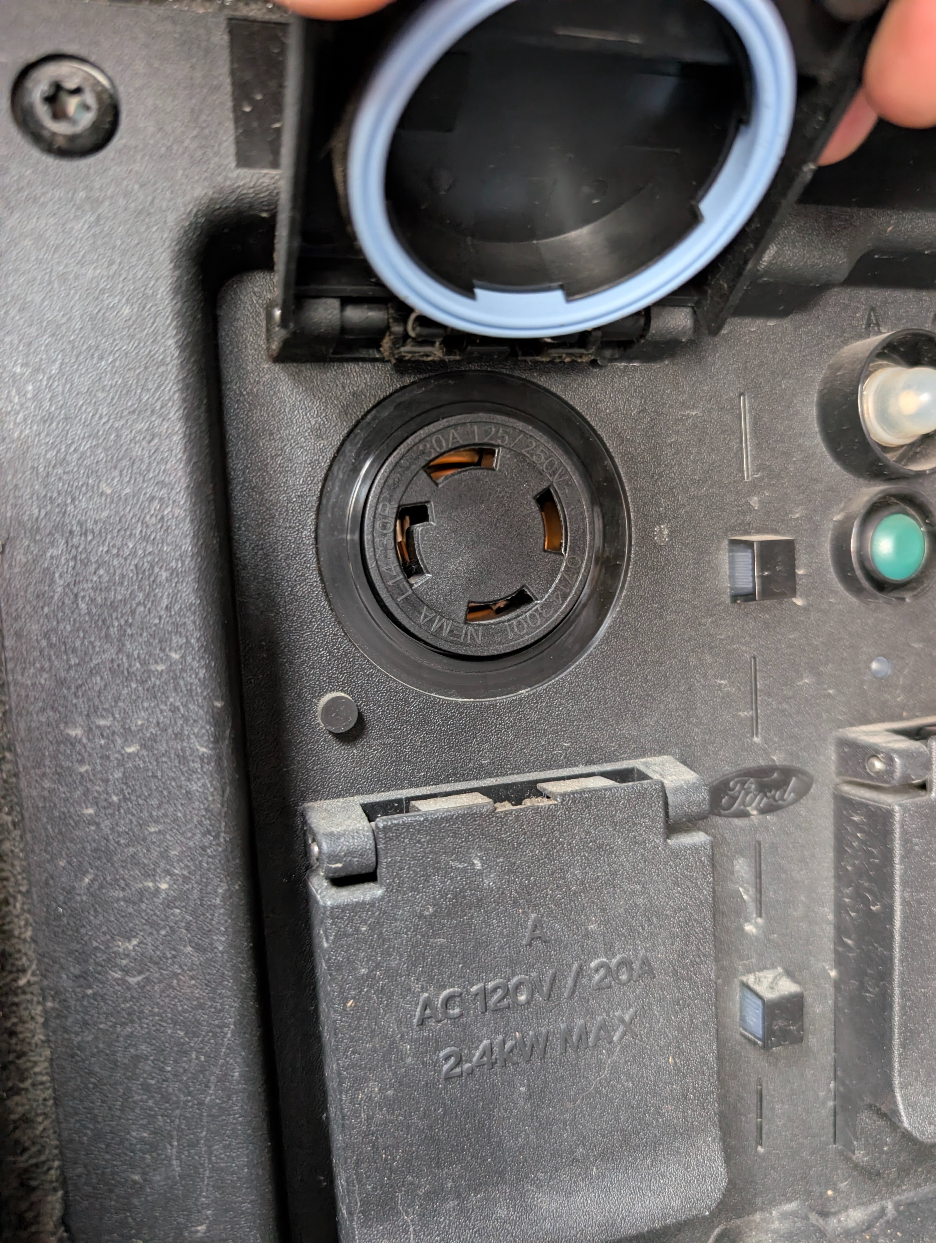

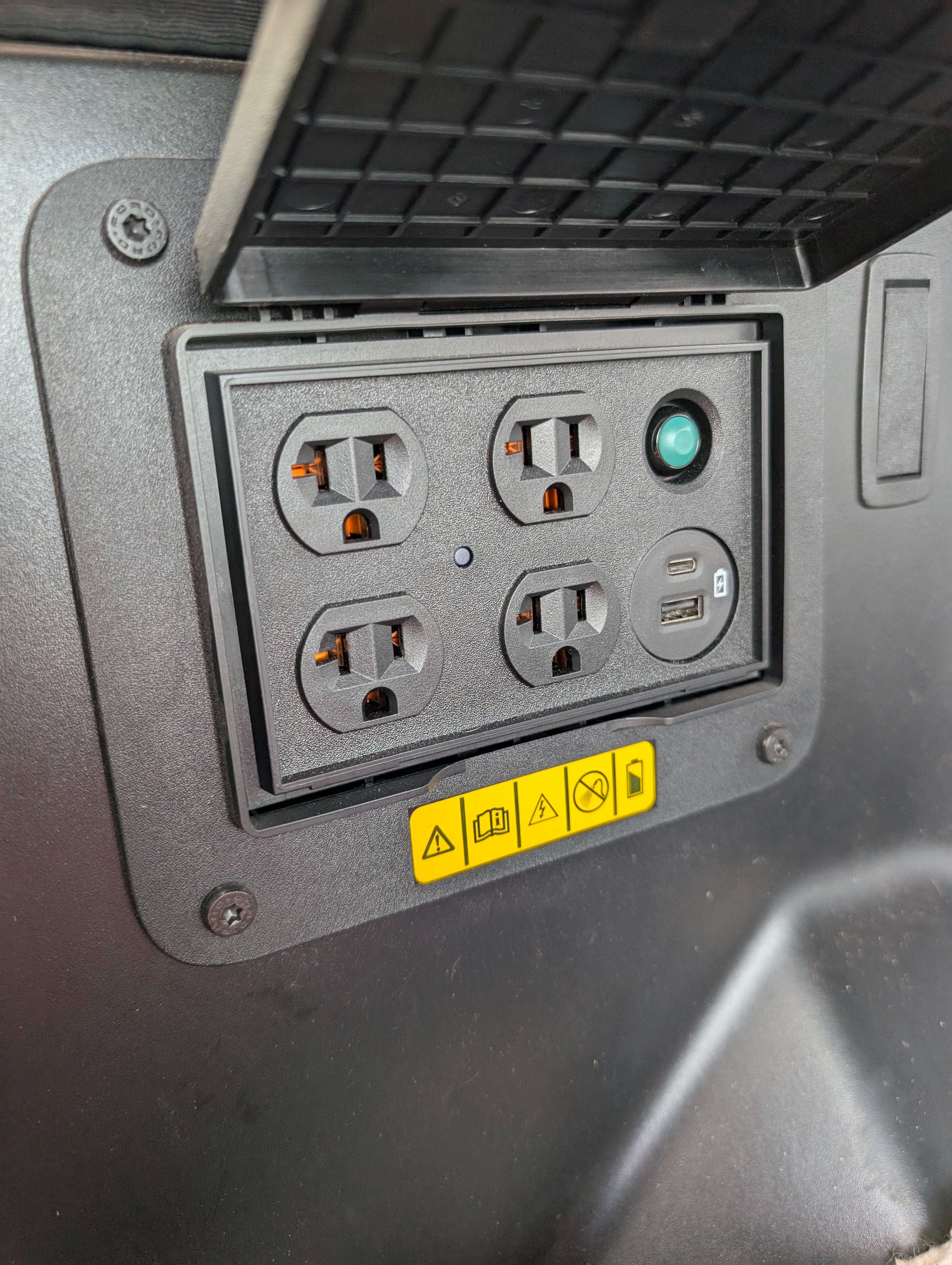

This is one thing I can say Ford did right.
