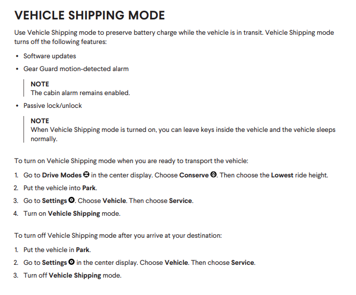

The Ford Lightning and Mustang Mach-E will put themselves into hibernation mode if left alone for two weeks (including no walk-by key detections, etc). This is the best solution and I’m willing to bet it’s an automatic solution for most BEVs.
Ford recommends bringing the high-voltage battery to around 50% State of Charge and disconnecting the 12V battery if storing the vehicles for 30 days or longer. But that’s assuming you won’t have the vehicle plugged in.
If I were to have a plan to leave my vehicles parked for a more than a month, the EV-specific things I would do are: Convince myself that my shore power was reliable enough for long-term storage. If so: plug in to a L1 or L2 charger; set the max charge level to 50%; shut off and lock the vehicle.
If I had to go somewhere and didn’t have time to plan it, I would leave the vehicle plugged in and call it good. Probably once I got to where I was going I’d set the maximum charge state to 50%.
If I was worried about shore power stability, I’d unplug the vehicle and disconnect the 12V battery.
There’s not much more to it for a BEV.

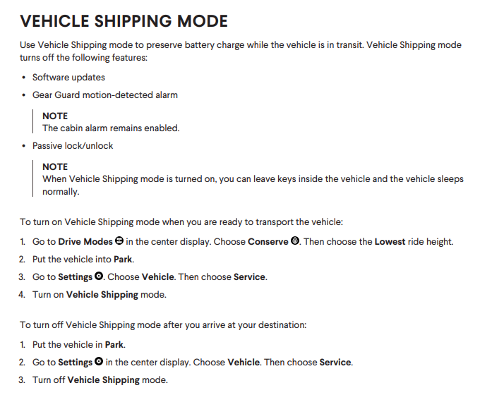

Rivian created a mode for mothballing and shipping... With the currently planned feature set, we will likely see modes to accommodate w wide range of use-cases like this:
