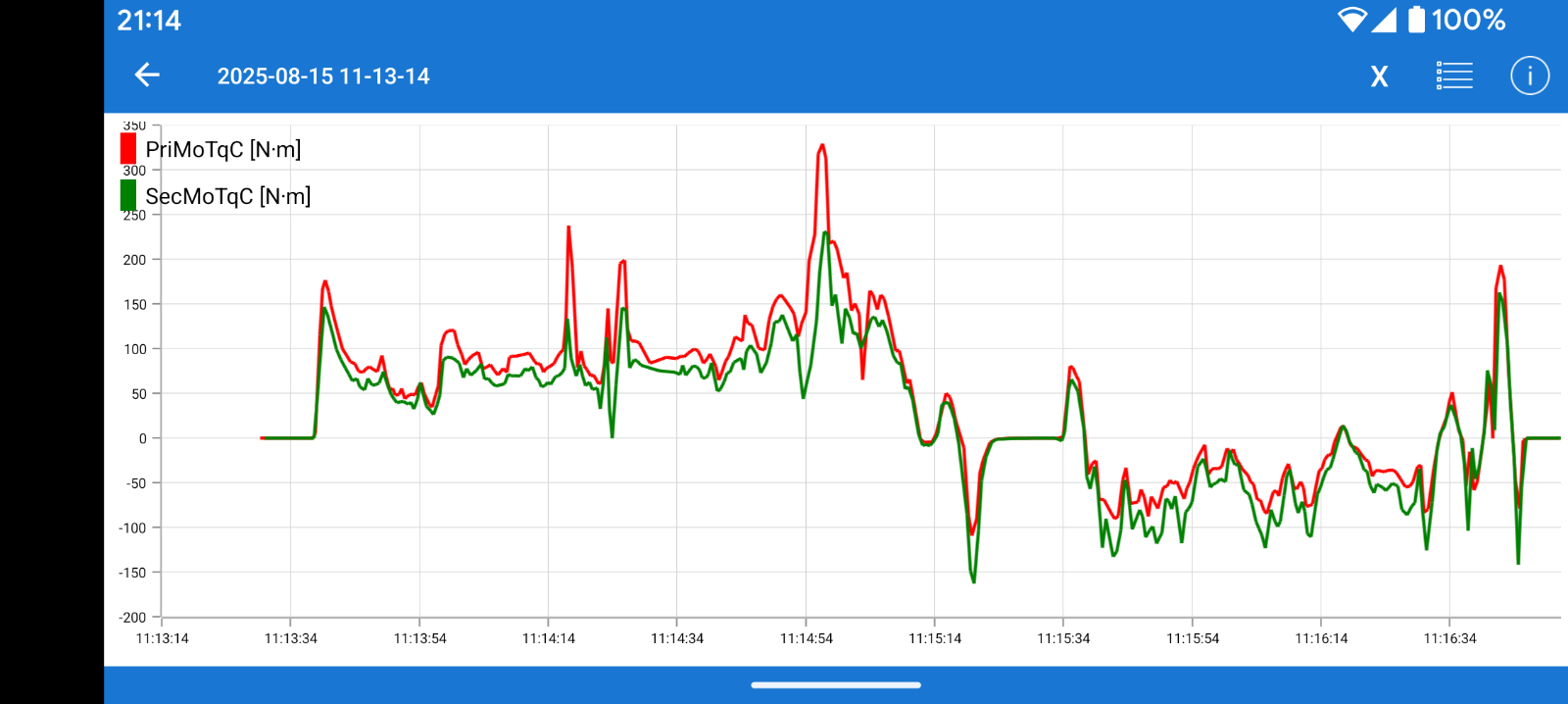

This final one is interesting. This is the Normal mode, no differential lock, but with traction control and one pedal drive on.
Torque:
For the most part, the rear motor is being commanded with more torque, but not at the same ratio as with sport mode nor off-road mode. These are almost at a 50:50 torque ratio, probably something like 52% rear, 48% front. I could do the math, but precision here is not a big deal.
Note however, there are a few instances where there’s a larger deviation. Just after 11:14:14 (a couple of times), there’s a huge spike in torque on the rear motor compared with the front. And again at 11:14:54.
If you look at the motor speed, you can see that there was slippage of the front tires just after 11:14:14 and that’s why there was more torque sent to the rear motor: to overcome that slippage.
But that spike at 11:14:54 is different. Let’s look at the motor speeds to understand that one.

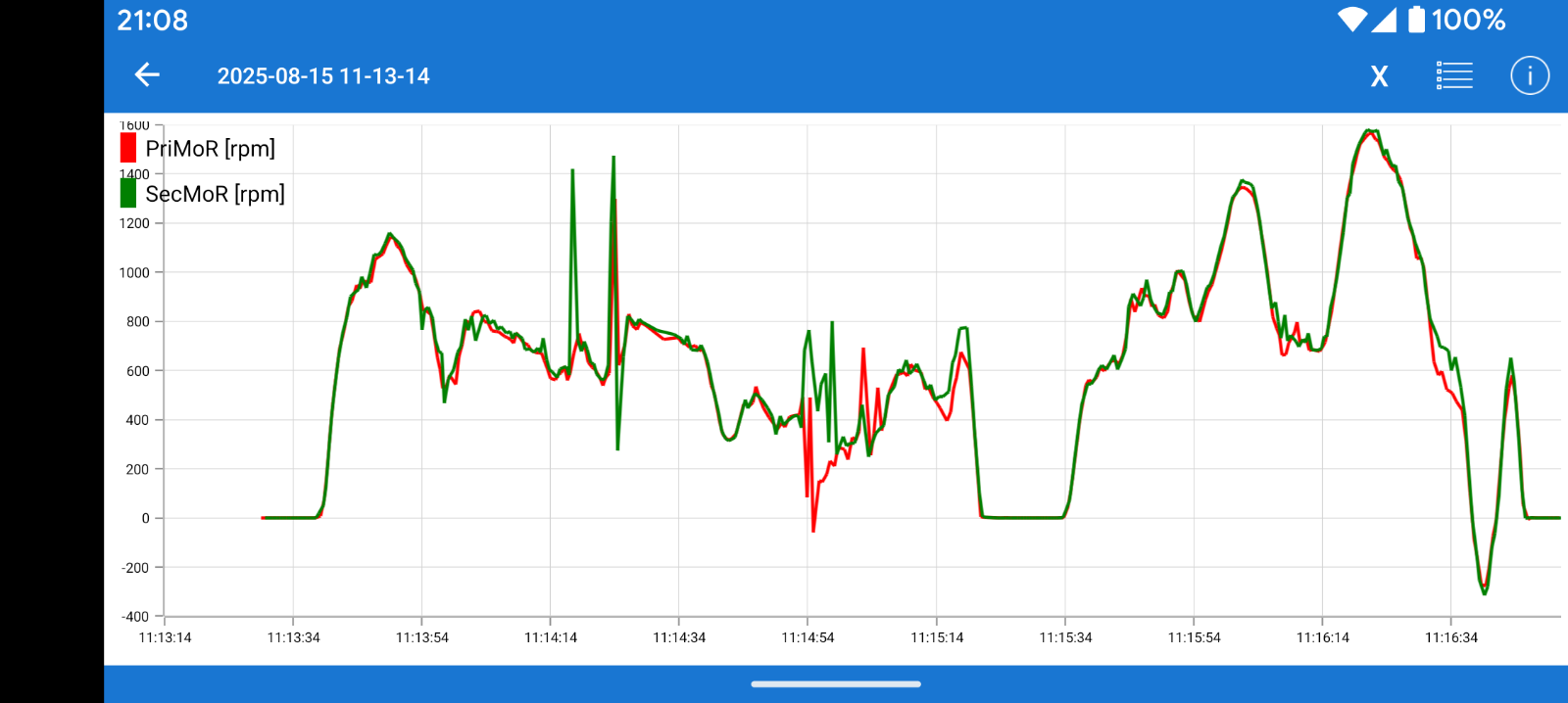

Motor speed:
For the most part, the front and rear motors have the same speeds. But look at that jagged blip at about 11:14:54. The rear motor not only dropped speed dramatically, it went in reverse. But the front motor did not. What the heck is going on there?!
This is where traction control comes into play. On a conventional ICE vehicle, the tires have to all turn in the same direction. There’s no way to decouple the front from the rear without some fancy differential/transfer case hardware linkages. It’s just not an option in normal driving. But in an EV, the motors do not have to be commanded to turn in the same direction. And when there’s a reason to command the rear to turn in a different direction from the front, the EV can be programmed to do that.
Some kind of slippage happened, but not just wheel slippage. The entire truck slipped down a deep rut in the trail here and the truck tried to recover control by reversing the rear motor while still allowing the front motor to turn forward. This allowed it to regain yaw control since the vehicle was not only slipping forward, it was yawing as well. As far as the sensors were concerned, the truck was out of control in yaw and the way to recover it was to reverse the rear motor and turn the front motor forward.
Fascinating!
Okay, that’s about all the data I have that shows anything new.
Summary: An EV can command each of its motors to put out different torques. It can also command each of the motors to spin at the rate it decides is necessary, including telling one or more motors to turn in the opposite direction from the others.
The thing @Chavannigans was talking about in the OP is relatively simple to make happen: turn the front tires at a higher rate than the rear tires. The reasons for something like this were explained in that OP.
There are other things that can be done with EVs that were simply not even conceivable with a gas vehicle: turning the rear wheels in reverse and the front wheels forward to regain yaw control, for example.
