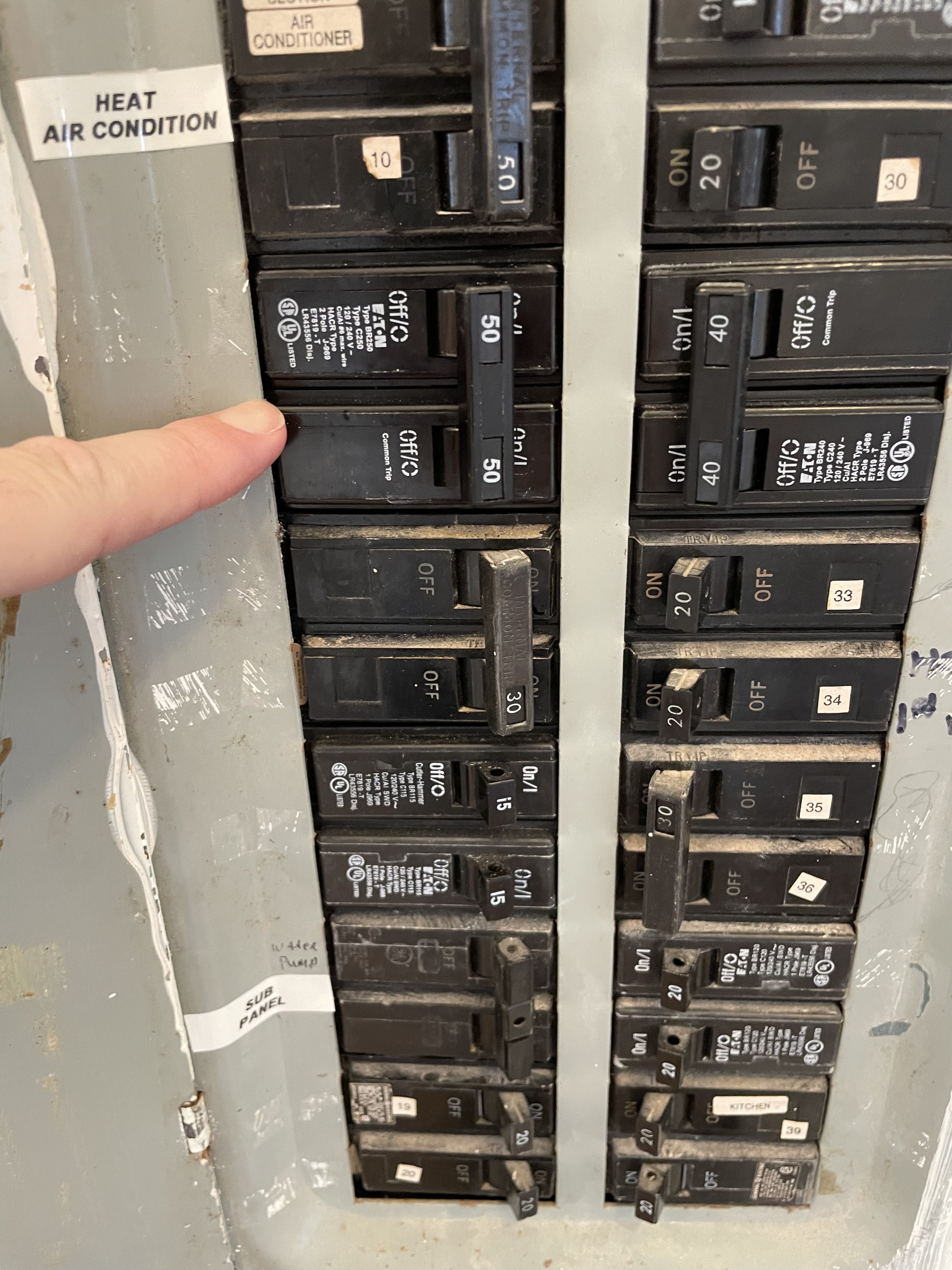

True, and in most municipalities, a panel upgrade is permitted work. We had an EC consolidate us down on some lower tier circuits to 15A and 20A tandems to open up a couple of spare positions when they installed our Tesla charger.
Just did that exact thing and was able to get a 50A.
Reactions: OIBScout
I would be especially cautious around kitchen and bathroom circuits, which routinely get tapped for 1500+ watt appliances. Bedrooms are fairly safe. The trick is, especially in older homes, or pre-electricity homes, to decipher how circuits can run into multiple rooms in curious and fantastical ways.
I agree. I have a separate circuit for garage recepts which presumably included my door motors. I rarely run power tools from my garage and I assume if I’m charging I’m not leaving anyway so may be able to make that work
What did you consolidate out of curiosity and have you been OK with that? Thinking same thing but trying to see where to give and take. Have some rooms now we barely use so cutting back a bit doesn’t seem like it would kill us
I honestly don’t know. You know I just moved in. This panel has been mislabeled at least twice prior to my ownership. 🤯
