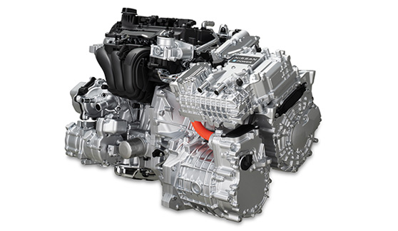

From the Nissan explanation of how E-Power works.
Since the engine connected to the generator only charges the battery and does not directly drive the wheels, it is possible to freely set the start timing and efficient RPM.
Sounds familiar, and clear cut. The generator only charges the battery. The very next sentence though offers some contradiction.
Generated electricity charges the high-voltage battery and directly drives the motor.
You might argue that the language is imprecise enough to mean, "charges the battery, and the battery directly drives the motor.", but that's not it. Check out the "high speed" portion of this image, and the text: "Driven by generated power while also charging the battery".
The are clearly sending generated power directly to the motor, while some left over amount is also sent to do battery charging. The battery is NOT sending power to the motor.
Still Not convinced?
Here is a one of the Lead Nissan Engineers (not Executive with an MBA) explaining how it works:
Here is an important excerpt, but by all means read the full page and what the full video:
... engine that generates electricity. That electricity moves to an inverter and then the brain of the vehicle will decide where that electricity goes from there, so the inverter can send it as DC current to the battery or it can send it as AC current to the drive motor, to drive the wheels or both at the same time ...
All of Nissans more detail explanations, contradict their more marketing oriented statement that the "generator only charges the battery". That statement is widely used by multiple companies, to hammer home that this is more like an EV, drives like an EV, the Gas Engine doesn't drive the wheels, but should be taken as literal engineering detail of how it works.
Read the Nissan page, watch the Engineers video, if you want to better understand how this works, but don't take a marketing statement to be factual detail about how an engineering process works.
