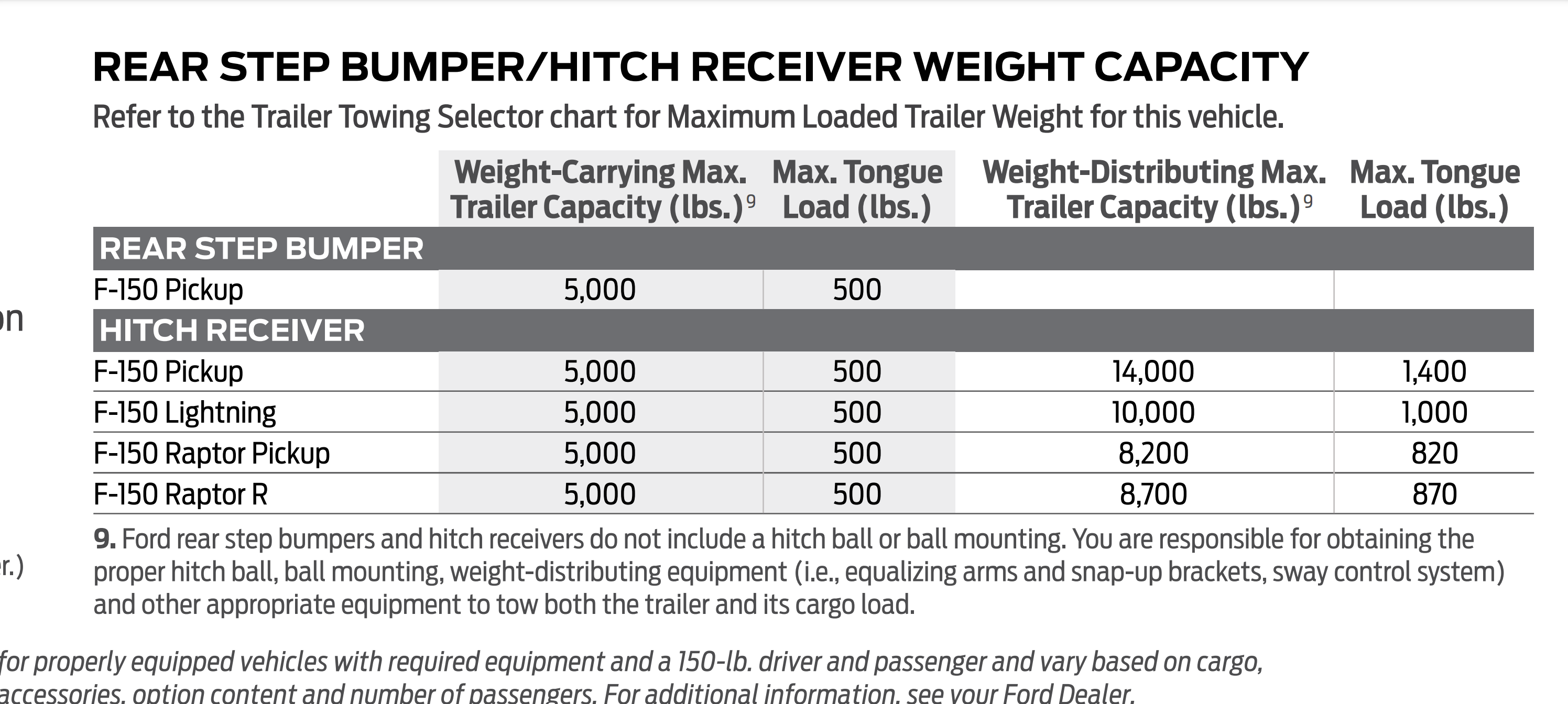

In general a WDH is needed if the weight of the trailer is more than about 50% of the GVWR of the tow vehicle.
In practice, for a light duty truck like the Lightning or Terra, they'll say you must use a WDH when the trailer weighs more than 5k pounds.
Example: ALL F-150s have a maximum trailer tongue weight of 500 pounds and a tow capacity of 5000 pounds on the built-in hitch. My Lightning has a rating of ~900 pounds tongue and ~9k pounds towing if I use a WDH.
My *guess* is that the 5000 pound number that Scott Keogh said when taking to Leno and had everyone freaking out is because he saw a preliminary data sheet with a maximum tow rating without a WDH. Both the Terra and the Traveler in both BEV and Harvester configurations will be limited to 5000 pounds without a WDH.
This is very interesting. I had no idea the tow rating and tongue weight capacity were so low on the Ford 150 without a WDH. In the smaller off road world trailer WDH cannot be used with articulating hitchs. Some of these off road trailers with articulating hitch carry a tounge weight of 900 to 1,100 pounds. So many folks are over capacity. Do you have any idea what the towing specs with and without a wdh on the latest model Rivians and Chevy trucks are?

They are the same.
Rivian is responsible and has a TW of 500 pounds and towing of 5000 pounds without a WDH.
Chevrolet apparently doesn’t care about other people on the road and uses 12% instead of 10% so their advertised tongue limit is 600 pounds and 5000 pounds towing without a WDH. That’s within the range allowed, but it’s irresponsible, IMO.
But it doesn’t really matter that Chevy is irresponsible because even more irresponsible people hitch up 2000 pound tongues to their bumpers without a WDH and don’t care who else they endanger.
Sorry for the rant. Bad towing really, really gets to me—I knew someone who was killed by an irresponsible tower.

They are the same.

The solution is actually very easy: For on-highway/on-road, use a WDH. Once you get off-road, swap to an articulating hitch. At low speeds, the dangers are so much lower, especially to others.
So even the Terra BEV will liklely not be able to handle trailers with articulating hitches and wdh over 500 pounds.
A responsible limit for all of the Scouts would be a max of 500 pounds tongue, 5000 pounds towing without a WDH. And it will be up to the owners to carry that responsibility forward. I have no doubt that Scout will be responsible here.

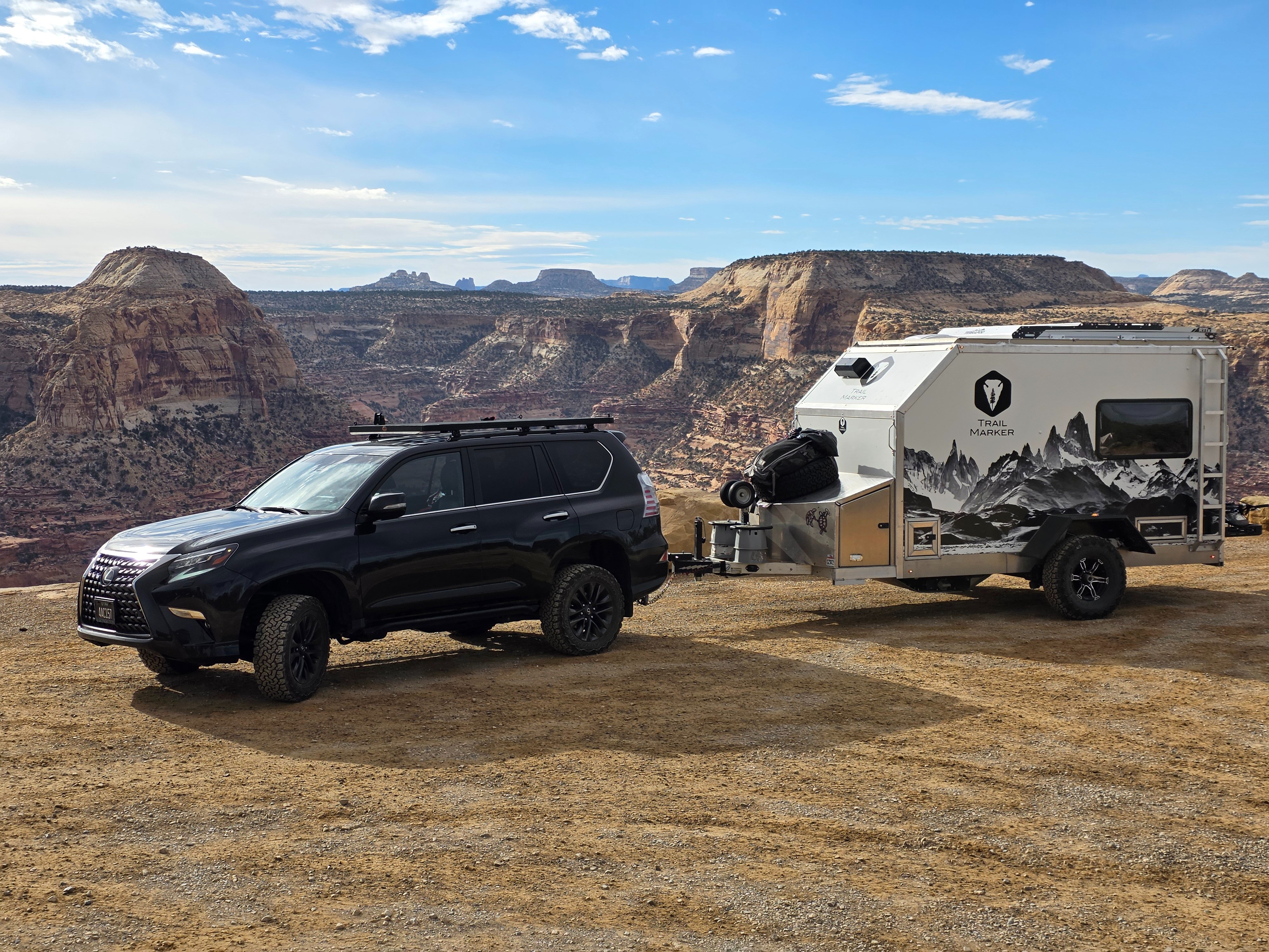

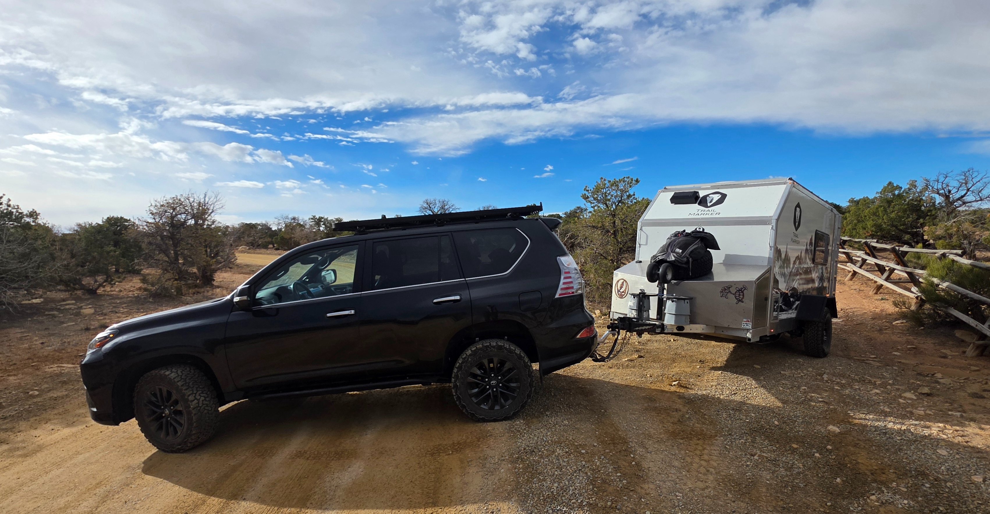

Yes a lot more responsible. In all the information I have absorbed neither Rivian or Chevy have ever mentioned a reduction in capacity without a wdh. That is exactly what I have set up an articulating hitch for off-road and a standard hitch for highway high speed travel. My trailer is light enough that my road set up just has a sway bar. I hate dealing with wdh hitchs which is why I roll with light trailer. For some off road rigs it is a major modification to be able to run both set ups.
