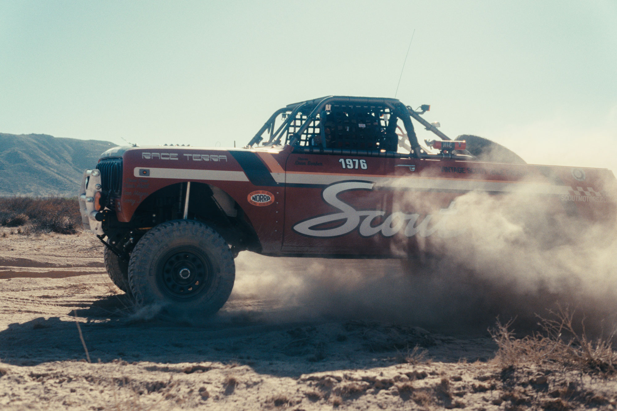

The sound of the breeze is soon interrupted by the roar of the Race Terra. It appears suddenly from behind the desert brush and cactus. Officials mark the time card, and Sean and Owen meet up with the chase crew.
“It looks like you’re losing oil,” shouts Dan over the motor. Sean cuts it off.
“Four-wheel drive is making a noise,” he responds.
The chase crew surrounds the truck from every angle, visually inspecting every inch. Leaks are searched for, bolts are checked for tightness. Sean and Owen hop out for snacks, a leg stretch, and a report about the day so far.
“Other than that, she’s doing good. Engine is running good, we’re feeling good.” Sean drives; Owen navigates. They have it down to a science. Owen starts shouting out numbers.

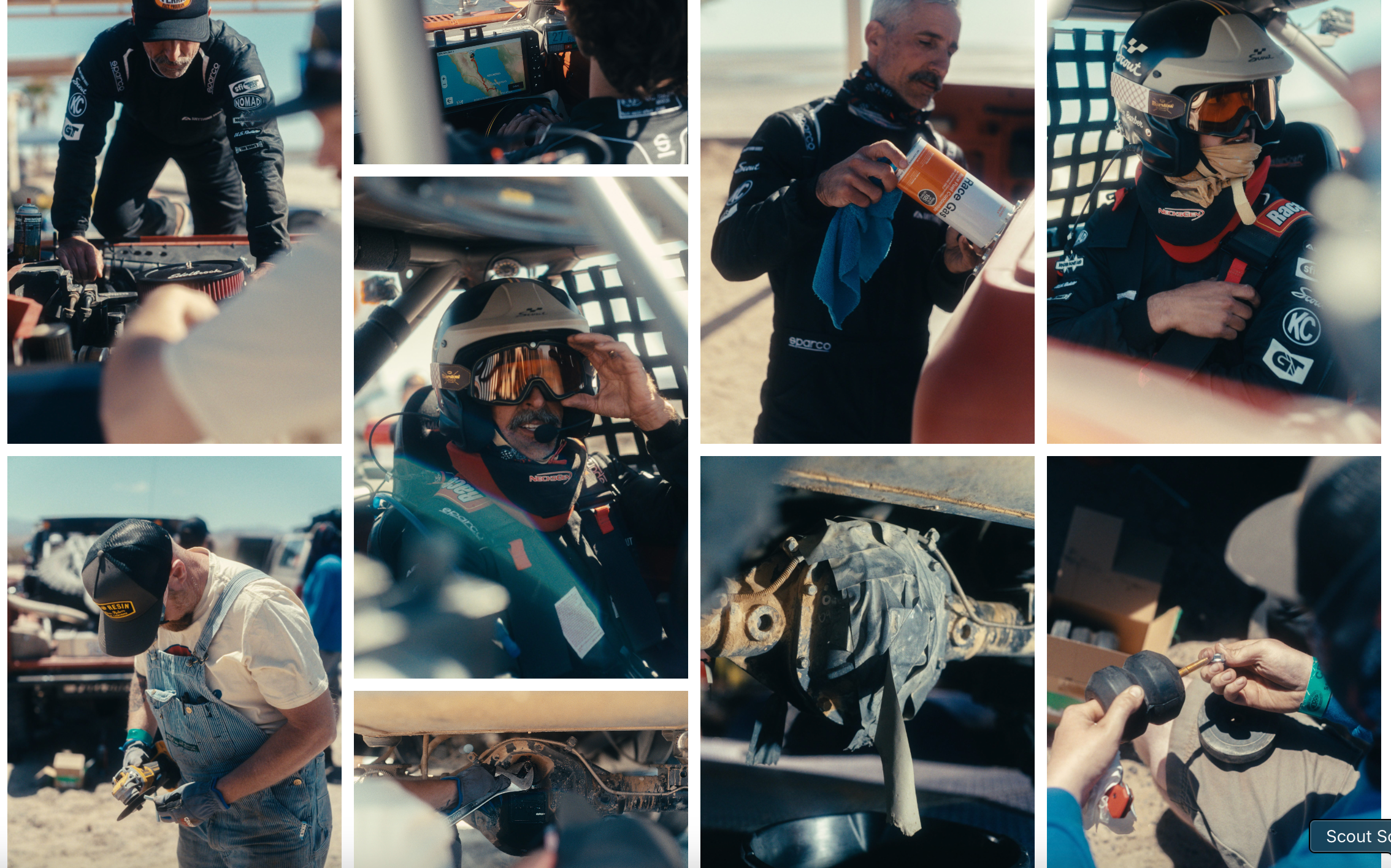

“Clearly!” yells Dan from under the truck.

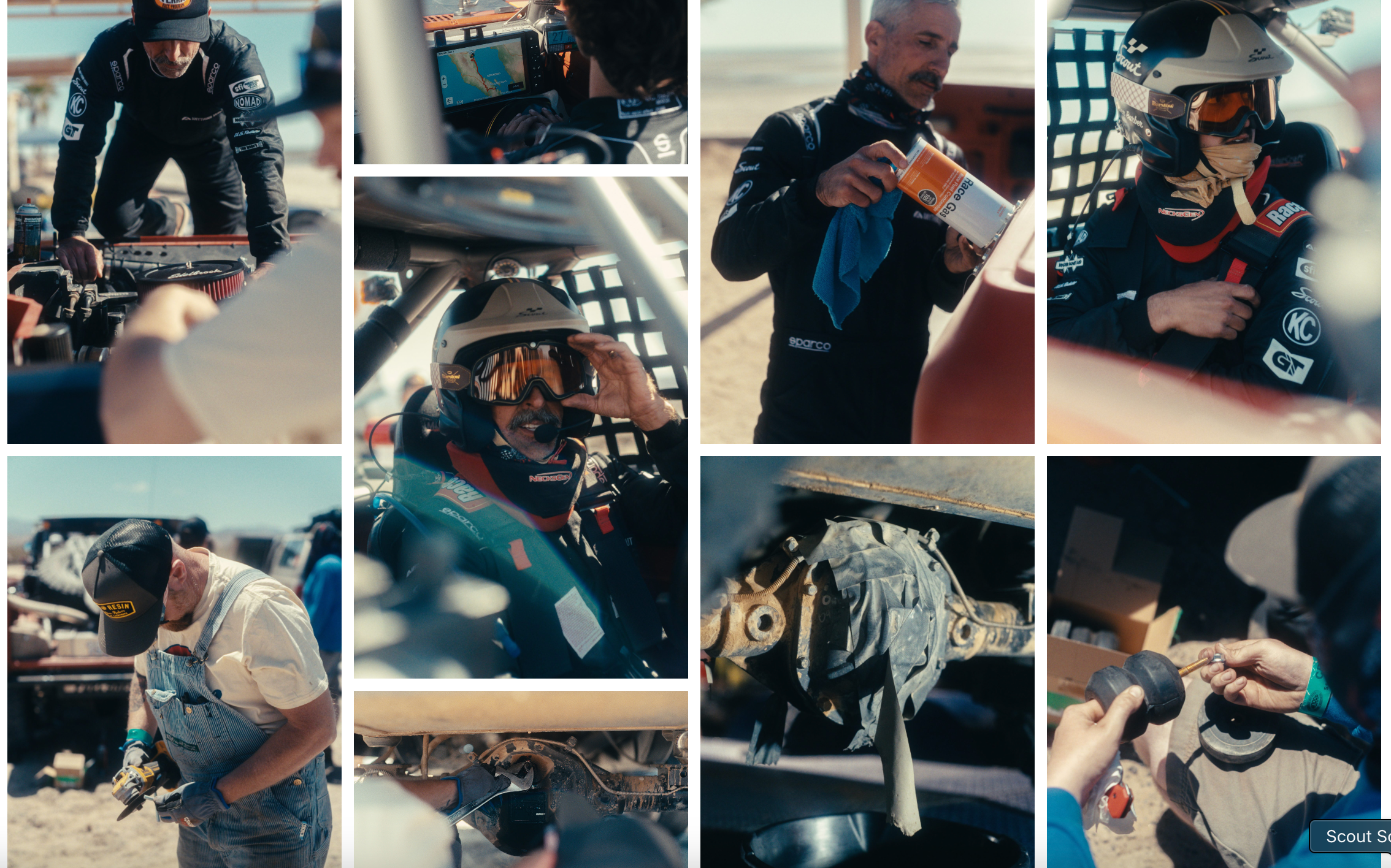

The rear differential is leaking again — bottoming out so hard the fuel cell is striking the diff bolt, tearing threads and causing play. We’d already tried grinding for clearance. Not enough, apparently.
“It’s like delicate surgery,” Dan says, screwdriver in hand, pulling the bolt.
He pulls out orange earplugs — those kinds of earplugs — seals the fix with a heavy coat of RTV and Gorilla tape. In racing, you do what you have to.
Sean thinks fast. “Let’s double up the bump stops.”
Owen calls out times. Another crucial job of the co-driver: clock management. “We gotta leave by 1:25. 1:30 latest.”
Larry grabs the bump stops box. Owen jacks up the truck. They get it done.
Sean mentions the four-wheel-drive noise again — not totally fixed. Noted for later. You prepare for everything… and still expect surprises.

Larry quickly uncouples the front drive shaft and packs on as much grease as possible. It’s a last-ditch effort to try and remedy the four-wheel-drive noise. The wind blows some sand and rocks in for good luck as we button it back up.
Even the livery looks fast. And it looks so good covered in dust. The 33” tires splash through the sand and over whoops, the late afternoon sun is to our backs as we race down towards Laguna Chapala. This dry lake is another incredibly iconic part of Baja. Back in the early days of desert racing, when some of the first Scouts were down here, Laguna Chapala served as a common pitstop for crews. But instead of chase trucks, they had Cessnas. The terrain was worse, support vehicles were less capable, and flying made the most sense. Fuel drops, parts drops, and a great view, too. The dry lake provided ample room for service. But also allowed racers to open things up. Some cars and trucks will easily see triple-digit speeds here. But again, our motto is “medium and steady.” The Race Terra is soon a mirage.
“Dry as a bone back there!” Dan yells the next time he sees the truck. He’s underneath the rear checking for any differential leaks. All clear. “The four-wheel drive is better, too, but not perfect,” Sean responds. And then they’re off again.

Last night, Dan and Larry were up until 12:30 a.m., swapping a differential while Sean and Owen slept. After concerns about a four-wheel-drive noise — and finding glitter in the diff fluid — we knew we’d need the fix before today’s rough stages. Camp the first night had infrastructure; tonight’s wouldn’t. Better to be ready.

At 10:35 a.m., the green flag waves. We’re off, south of San Felipe, straight into a special stage. Immediate racing.
A bridge spans a dry riverbed — traffic and tourists overhead; Race Terra roaring underneath. Spectators crowd above and alongside, cheering as we vanish into the desert.
Most trucks out here run big V8s. We stuck with a small, original four-cylinder. It’s a unique choice — and it sounds incredible, screaming through the sand.
The first time Sean and Owen meet the crew today, it’s quick: hop out, snacks, stretch, status check. Dan and Larry dive straight into the dirt, checklist in hand.
“It’s a whoop-fest, man,” Sean laughs, pulling off his helmet.
