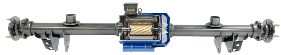

I feel like a few of you out there can answer (explain) this....just seems like a simple idea that could help with decreased range issues while pulling trailers.
It won't work due to the fact that you cannot get more energy out than you put in. (Otherwise you could have perpetual motion.) Maybe during braking it could provide some additional power to re-charge the battery, but when the vehicle is pulling, it will simply add additional weight and require more energy from the vehicle's battery.
YES! this! ^^^^^
There isn't any answer for losing energy without regenerating it, and if the source of energy is electricity being consumed to propel the truck forward, then you add more resistance to regenerate more power, well, your equation ain't so great. It becomes a simple physics equation related to the first law of thermodynamics:
The First Law of thermodynamics is a formulation of the law of conservation of energy, adapted for thermodynamic processes. A simple formulation is: "The total energy in a system remains constant, although it may be converted from one form to another." Another common phrasing is that "energy can neither be created nor destroyed" (in a "closed system"). While there are many subtleties and implications that may be more precisely captured in more complex formulations, this is the essential principle of the First Law.
It distinguishes in principle two forms of energy transfer: heat, and thermodynamic work, for a system of a constant amount of matter. The law also defines the internal energy of a system, an extensive property for taking account of the balance of energies in the system.
The law of conservation of energy states that the total energy of any isolated system, which cannot exchange energy or matter, is constant. Energy can be transformed from one form to another, but can be neither created nor destroyed.
Thank you for this clear explanation. I've had the same question for a while now.
