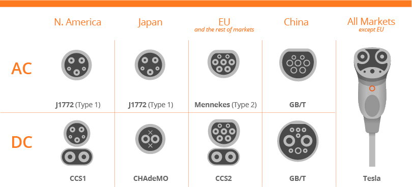

I know you are saying J1772 but the actual connection would be CCS1. CCS1 has the additional inputs for DC Fast charging. J1772 will get level 2, CCS1 gets the Level 3.

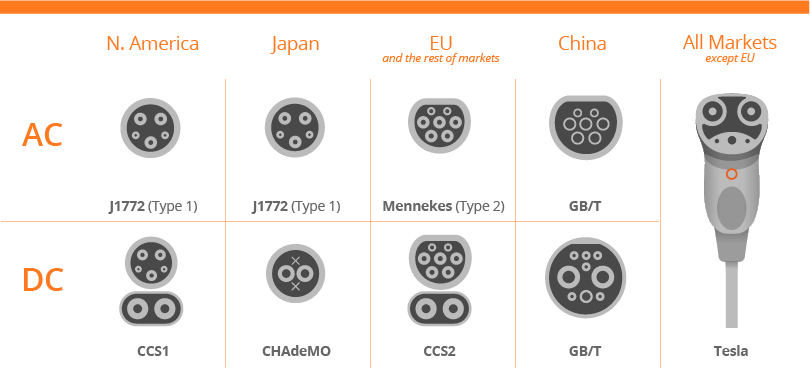

Interesting.
So the CCS1 has the addtional 2 ports for DC on the bottom, supporting L3 charging. The only issue with this is those who have a J1772 only, like me, wouldn't be able to use the CCS1 charger on my J1772 rig. Kinda a pain.
Interesting.
That's not true, the J1772 is the same as the top portion of the CCS1. So a J1772 Plugs into the CCS1 for AC charging.
If you have ever been to a location that has a free charger it is typically a J1772. All CCS1 vehicle (id4, ev6, etc) can plug in no issue. All other styles (Tesla/chademo/etc) can plug in with the use of an adapter
I think you misunderstood. I have a Jeep Wrangler 4xe. So if I were to install a male CCS1 charger, it would not be able to charge my Jeep, as the bottom DC ports would interfere with it plugging in.
Ah I understand you now. The reason a jeep 4xe has only a J1772 is because it's battery is small and cannot handle nor does it need DC fast charging. J1772 cannot handle as much charging speed as a CCS1. Which is why it is most likely the CCS1 port that will be on a Scout. But you can still use the J1772 to plug into a CCS1 and charge at level 1 and level 2

Where are you getting a hard wired J1772? in your home? if you get a J1772 hard wired wired in your home then that 100% will work with a Scout that has a CCS1. Nobody does DC charging in their home because all homes run on AC power.
