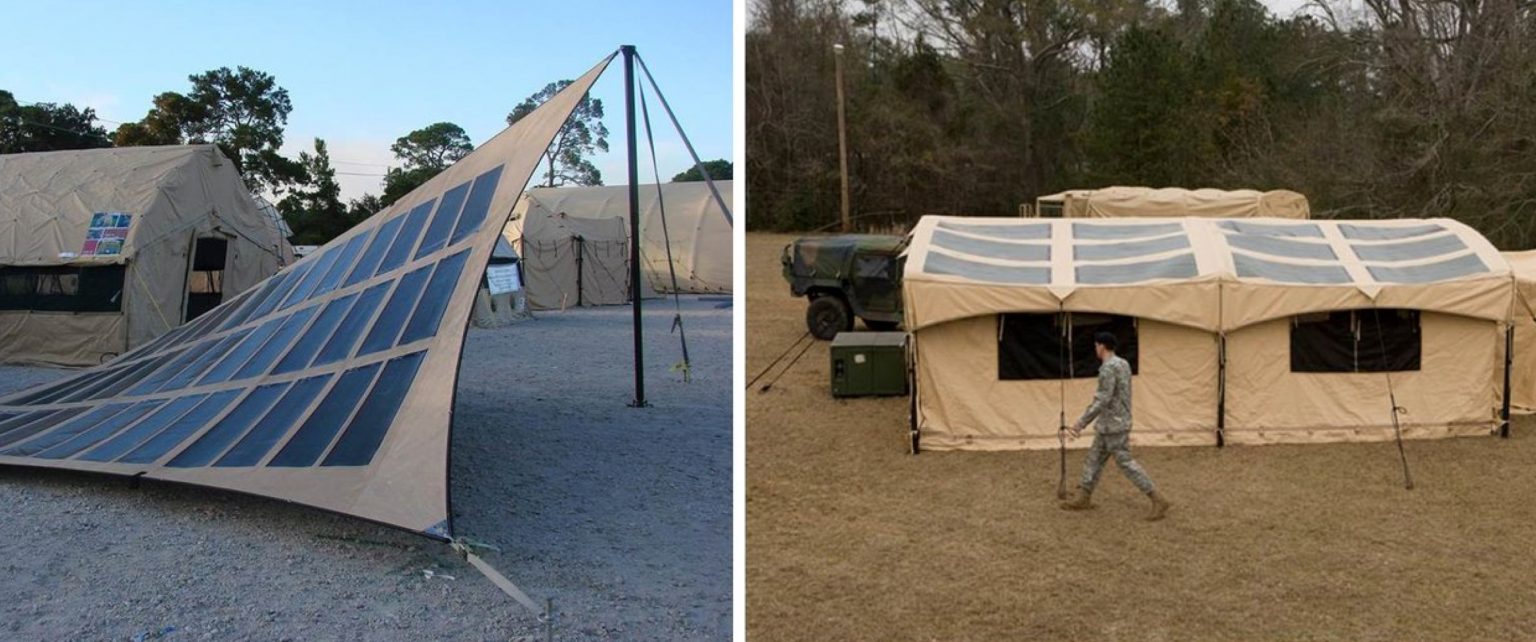

Could be mounted on a pop-up tent to charge at all times or while camping and parked you could set out a bunch or solar if you need more power
