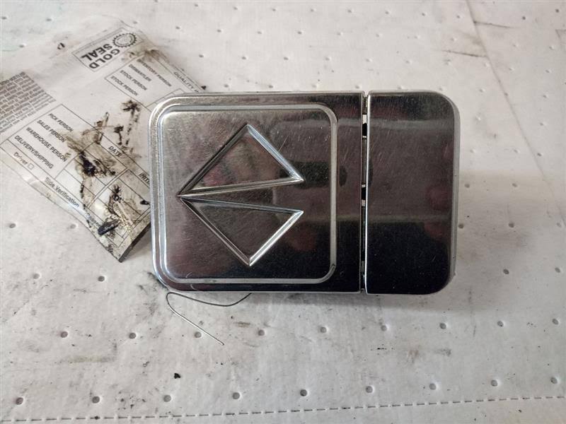

This is the door handle for an 80s-early 2000s door handle. Flush, metal, robust, mechanical, etc.
