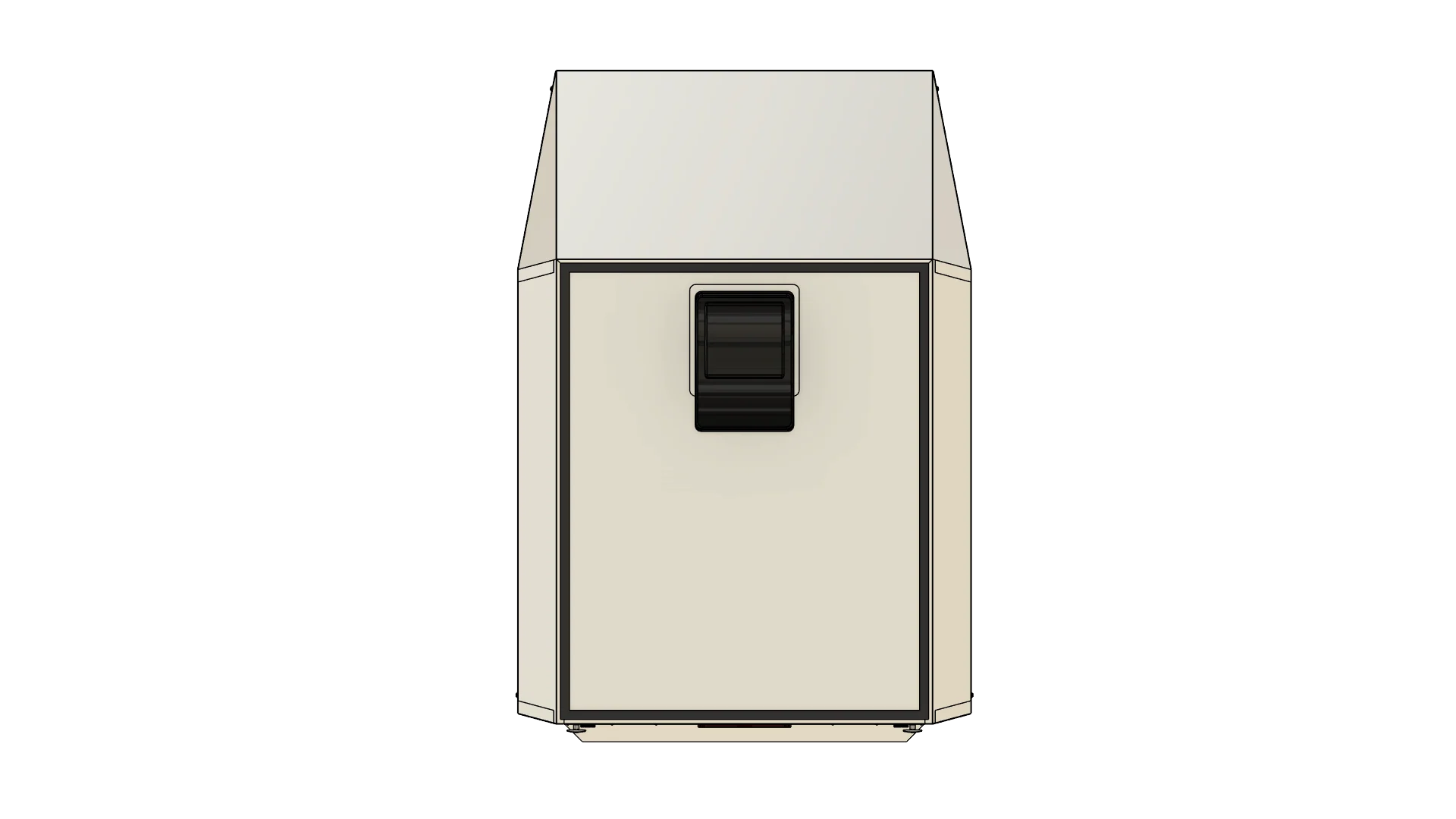

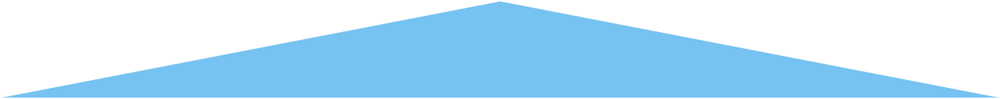

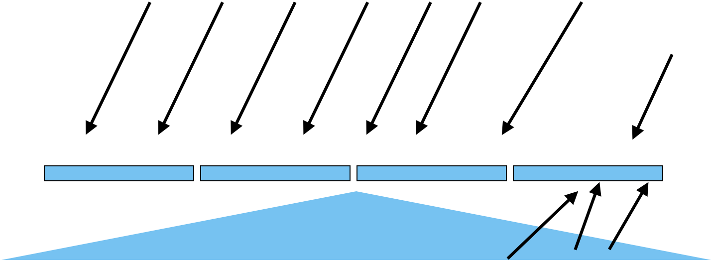

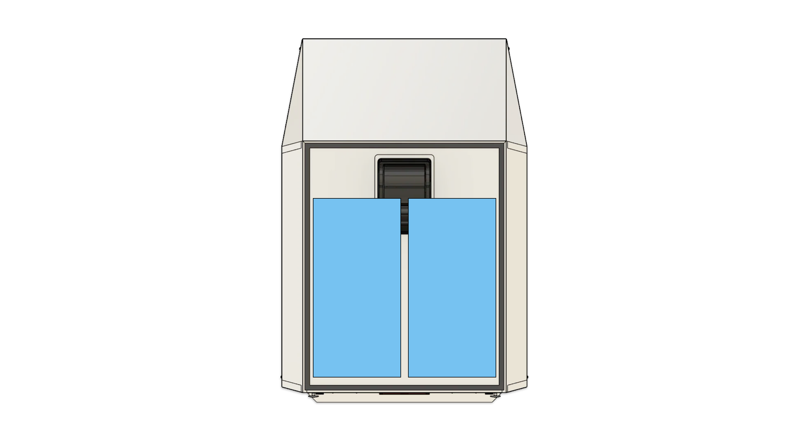

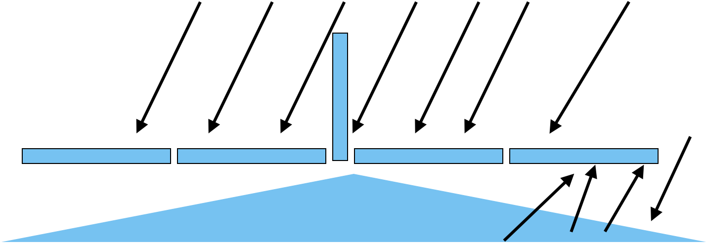

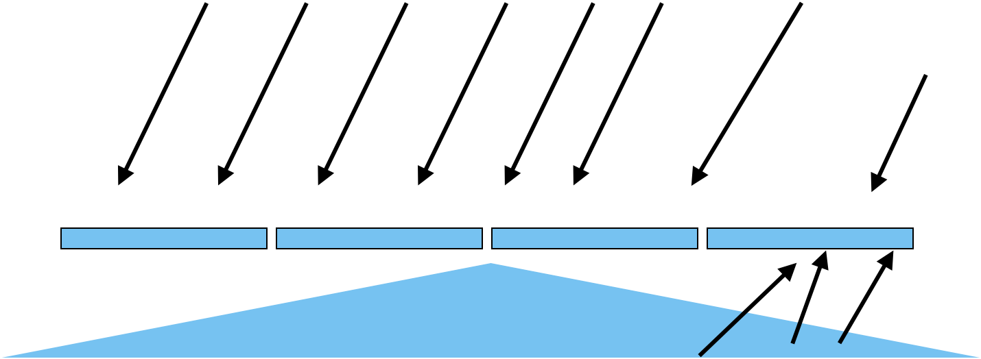

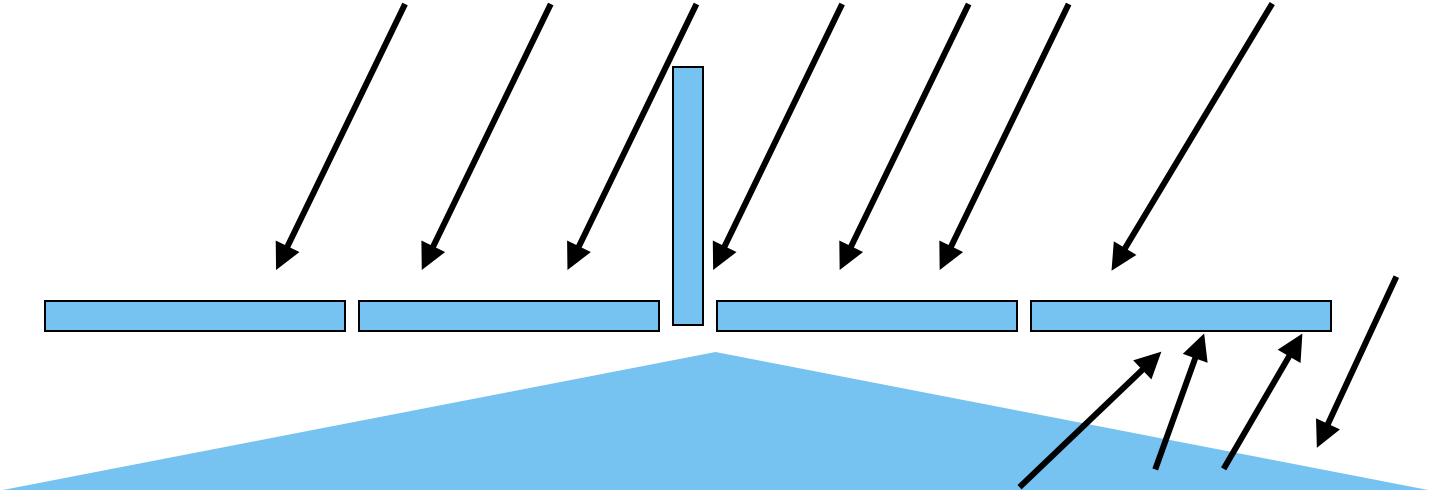

I think I am going to buy some bifacial solar panels and work with some of the guys in our engineering department to come up with a folding roof mounted solar solution. I would also use a 270 degree awning with reflective coating to bounce some light to the bottom sides of the panels.
I would first check to see what a meaningful output would be to you because it takes a lot of panels to achieve good wattage. Below is a pretty common setup for vanlifers and it only puts out 800W. Lots of panels there and it works for recharging things you're using in the van, but not enough to charge an EV...I ran that scenario through ChatGPT and it estimated you'd only be adding like 6mi a day in range with this setup.
  • Wow

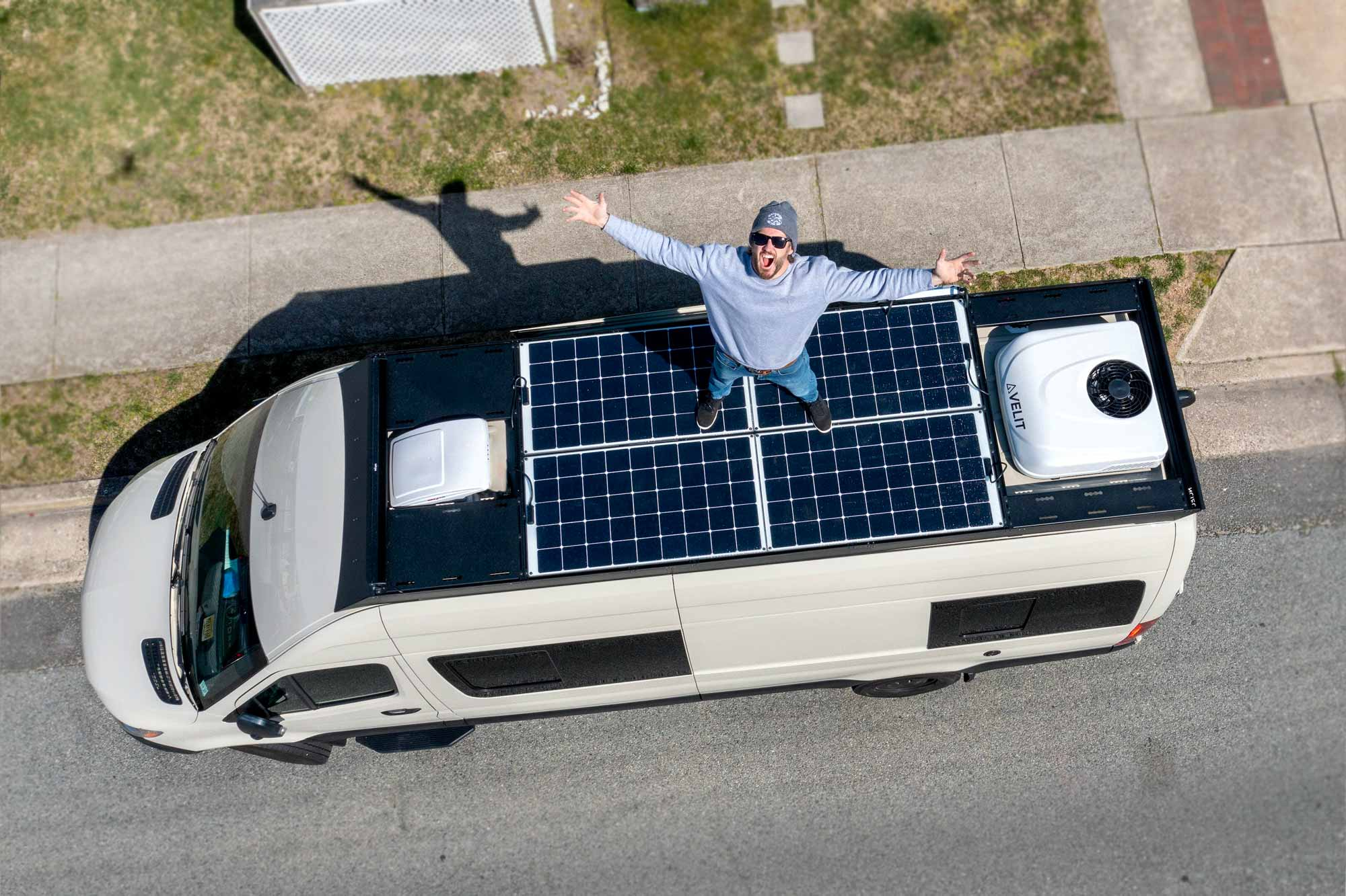

The stick on type panels many people use for vans or RVs dont produce as much wattage compared to fixed panels. Even at five miles a day is worth it to me though if I dont need to run a generator to run my camp. Especially on 3-5 day trips.
I was looking at these. Four of them could hit 1kW (in optimal conditions)
My thinking is I would have two panels permanently mounted side by side longways on the roof. When in transit there would be two bifacial panels on top of them. Once I get somewhere I would either unfold the upper panels to give me one panel hanging over each side of the camper shell, or slide them out on a track system.
CLOSED (From the rear of the vehicle)
OPEN (From the rear of the vehicle)
(Reflective Awning deployed beneath the panels)
The panels hanging over an awning like this would be catching light from the top and bottom.
I suppose I could add some briefcase panels into the mix if I needed more. Or even duplicate the setup on the rack of the pickup

Be careful with thermals with the reflections from the awning. PV reduces efficiency as their temperature increases. You’ll want to make sure there’s enough airflow and especially allow for some vertical air flow so you get a good convecting flow.

I have also seen some pretty interesting results from people trying vertical panels. There may be a way to slip a 5th on in there without taking up too much space.

If you do it that way, you'll want the potentially-shaded panels to be in parallel rather than series so they don't crash the generating capacity.
Good point. I am way out of my depth with a lot of this stuff.
The plan would be to have the roof top MaxxAir Deluxe fan mounted centered on the roof with the exhaust facing towards the panels.
The panels would sit on a raised roof rack above the fan. I would hope this could help generate enough airflow to keep them from baking.

If you want a ready made solution, there is someone already selling something like what you describe. I don't know anything about it other than what I have seen online, so I can't vouch for them, but I thought I would pass it along.
